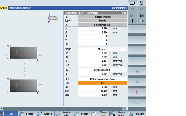

AAC – Automatic Approaching Cycle
  • Approach to the workpiece with contact  detection by means of motor current evaluation  of the grinding spindle*.
  • Measuring sensitivity adjustable via user interface
  • Individual setting of oversize possible after  contact detection
Customer Benefits
Set limit values for contact detection
  • Significant reduction of air cuts, so that the grinding process starts directly at the actual dimension of the workpiece
  • Extension of the handling capability, especially  when the structure-borne noise on the part cannot be  determined clearly
  • Full integration in the grinding cycle package
Parameter setting of the startup strategy after contact detection
