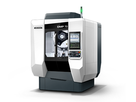

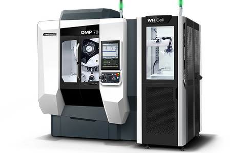

DMP 70
Vertical high speed machining center
Max. X-axis stroke
28 in. 700 mm
Max. Y-axis stroke
17 in. 420 mm
Max. Z-axis stroke
15 in. 380 mm
Max. workpiece diameter
11 in. 290 mm
Max. workpiece height
23 in. 580 mm
Max. workpiece weight
882 lbs. 400 kg
Max. workpiece length
33 in. 840 mm
Max. workpiece width
17 in. 420 mm
Themed image DMP 70 by DMG MORI
Compact production machine for application in medical technologies, in the field of Job Shop, Aerospace and other challenging industries
  • 10,000 rpm inline spindle with up to 78 Nm; 24,000 rpm inline spindle with up to 48 Nm optional available
  • Up to 2 g acceleration for quick chip-to-chip-time of only 1.5 seconds
  • Machining of complex parts based on optional 5-axis simultaneous ability
Highest precision and dynamics in the field of production
  • Comprehensive cooling measures and direct absolute path measuring system in basic machine
  • Highest rigidity and milling performance with rapid traverses of 60 m/min in all axes
  • High-precision manufactured machine components ensure the highest accuracy
Productive machine design with perfect possibility of automation connectivity
  • DMG MORI Stealth Design with inner doors to avoid chips falling outside of the machine
  • Highest flexibility regarding the integration of automation from right side, left side and from the front of the machine
  • Smallest space requirements of automation solutions, e.g. DMP 70 with WH 3 Cell needs only 8.8 m²
High productive machine concept
Highest precision, rigidity as well as maximum flexibility in the field 3-axis and 5-axis machining
  • Minimal footprint of only 4.2 m²
  • Highly dynamic tool magazine with a chip-to-chip time of only 1.5 seconds
  • Maximum spindle stiffness based on spring preloaded bearings
  • Comprehensive portfolio of chip conveyors and coolant systems
DMP 70

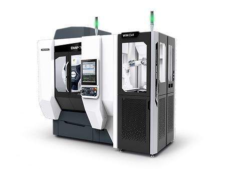

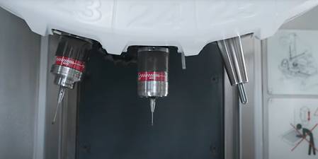

In-process measuring on the DMP 70 with WH 3
