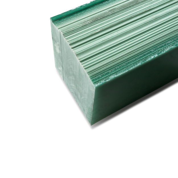

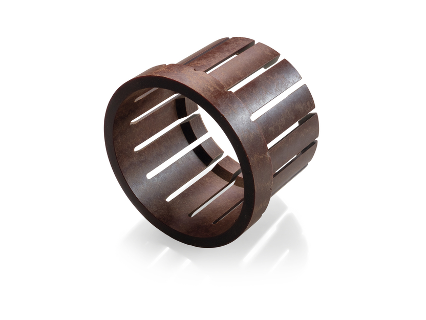

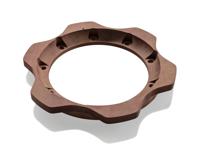

Compared to thermoplastics, which AMENT plastics also uses, thermosets place significantly higher demands on machining. “While the first produces normal chips, thermosetting plastics produce dust that must either be extracted or flushed away, which in turn leads to an aggressive sludge,” says company founder and CEO Klaus Ament, explaining the difference between the two plastics. However, depending on the application – for example in electrical engineering – wet processing is not possible because the material then absorbs too much moisture. Thermosets are laminates made from synthetic resins. The layers consist of hard paper, cotton fabric or – since the middle of the 20th century – epoxy glass fiber. The latter in particular is considered to be very abrasive, which means that harder tools are required. “So every plastic has its own parameters, which experienced specialists have to bear in mind during production,” says Klaus Ament, pointing out the importance of good personnel.

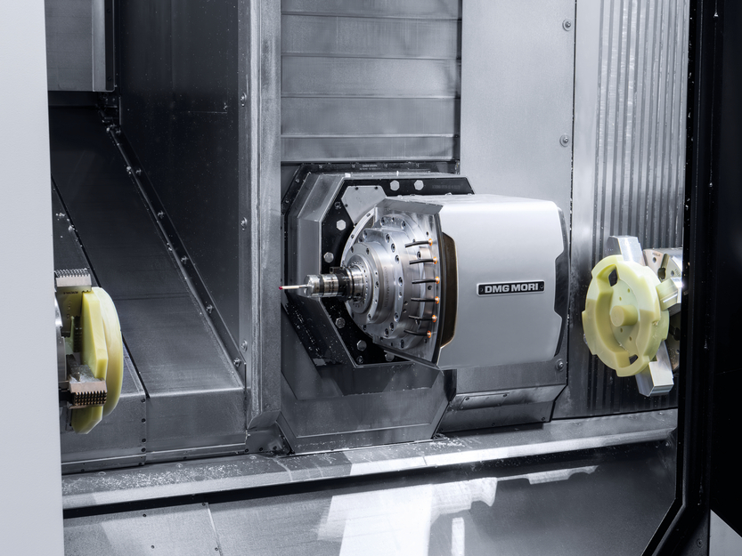

AMENT plastics relies on modern CNC technologies to machine the often complex geometries. 5-axis simultaneous milling and 6-sided turning & milling are now standard. Erik Fleischmann, production manager, believes that complete machining on turn-mill centers is the right way forward:

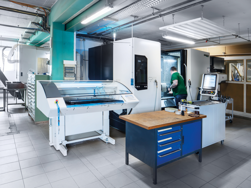

“The original production process involved at least two machines and repeated reclamping. This takes much longer, ties up machine capacity and the accuracy is more variable.” The investment in a CLX 450 TC was therefore a major milestone. Together with a colleague, Erik Fleischmann was responsible for the acquisition of the turn-mill center. Good experience with older turn-mill machines from GILDEMEISTER led him to DMG MORI. The choice was between the CTX beta 800 TC and the CLX 450 TC. “As space is limited, we opted for the smaller model,” he recalls. “Integrating several machining processes into one work area is a good way to expand capacity.”
Automated production with bar loader and parts removal
With travels of 750 × 200 × 1,100 mm, the CLX 450 TC covers a wide range of components. The counter spindle and the compactMASTER turn-mill spindle make it a versatile machining center for one-hit production. If required, Erik Fleischmann can also integrate in-process measurement: “Occasionally, the machine produces a series of parts. In such cases, continuous quality control in the work area saves time.” A bar loader and a container for finished parts have also been installed so that these series can be produced during unmanned night shifts.
