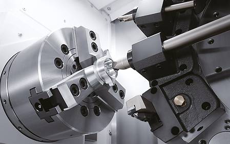

Wasino A 150Y 18
WASINO A 150Y | 18
Ultra-high-precision Machining
Max. workpiece diameter
240 mm
Max. workpiece length
245 mm
Max. bar capacity diameter
67 mm
Max. X-axis stroke
180 mm
Max. Y-axis stroke
100 mm
Max. Z-axis stroke
350 mm
Fanuc
Process integration
  • Largest number of tools in the class: 18 tools
  • Integrated machining in the smallest floor space
  • Proven experience in diverse machining, from round to irregular workpieces
Super-high precision
  • Thermal displacement (at cold start): ø 4.0 μm Circularity: 0.8 μm
  • Adoption of a pre-tension structure suppresses thermal displacement and realizes high positioning accuracy
  • Stable machining accuracy thanks to stainless steel covers
High rigidity
  • The horizontal, single-piece, scraped cast iron slideways with superior damping performance and a high resistance to chatter facilitate stable machining
  • Minimized distance between the axis travel reference guide and spindle restricts effects of generated heat
Expandability
  • Versatile system variations to accommodate diverse production needs
  • A wealth of highly practical applications and peripheral devices available
