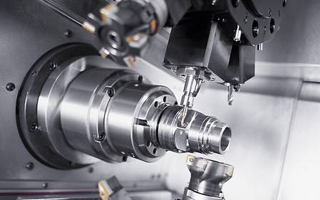

4-axis production turning with 3 Y-axes, B-axis and 3 turrets for up to 36 driven tools for max diameter 65mm
Automatic turning with both collet and chuck application
- Main and counter spindle with 7,000 rpm, 75 Nm, 16 kW (nominal)
- SIEMENS models are 2 turrets twin concept, 3 turrets and 3 turrets plus B-axis
- FANUC model is 2 turrets
Up to 36 tool stations
- Total of 12 VDI 25 tool stations with Trifix per turret, each can be driven.
- Driven tools spindles up to 8,000 rpm, 10 Nm, 1.5 kW (nominal)
- B axis with torque motor and direct measure system
