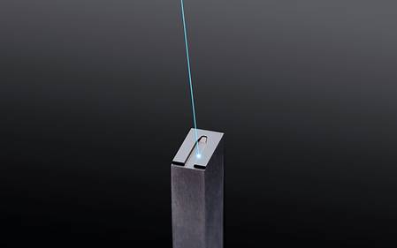

3D laser ablation for the production of miniature molds, extrusion dies, inscriptions and engravings
  • Contact-free machining without need of electrodes and without tool wear
  • Highest repeatability and reproducability
  • Machining of standard materials up to Advanced materials like glass, ceramics and tungsten carbide
  • Surface qualities up to Ra < 0,1 µm in carbide tools
