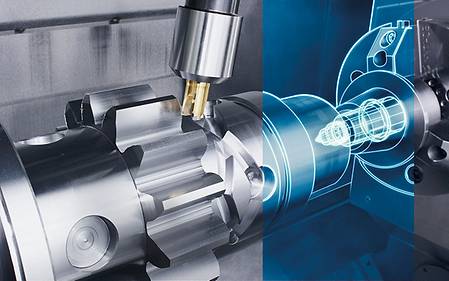

  • Perfect combination of 6-sided complete machining and tailstock function
  • Automatically load and unload a tailstock centre into the chuck of the main spindle or counter spindle via the milling spindle and into the mgazine
  • Support of long and slender workpieces on the main spindle thanks to the synchronous counter spindle tip
Customer Benefits
  • Higher component accuracy due to automatic change without opening the door (heat flow constant)
  • Position-locking the spindle with the tip leads to increased process safety
Counter spindle tip
Shortened programming time thanks to the simple programming interface
