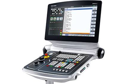

User interface Presentation of the program condition with additional markers (EPS) for the sub-program. Input of remarks by the operator, or automatic by the GILDEMEISTER programing.
  • In combination with the Gildemeister structure programming, A safe and fast reboot of the machining program after an interruption
  • Easy program operation especially with multiple spindles or tool magazine
  • Displays the process status of the workpiece
Customer Benefits
  • Display of the detailed status on the controller
  • Enter remarks automatically by the GILDEMEISTER structure programming.
  • Safe re-entry into the program by the press of a button instead of searching for a specific block.
