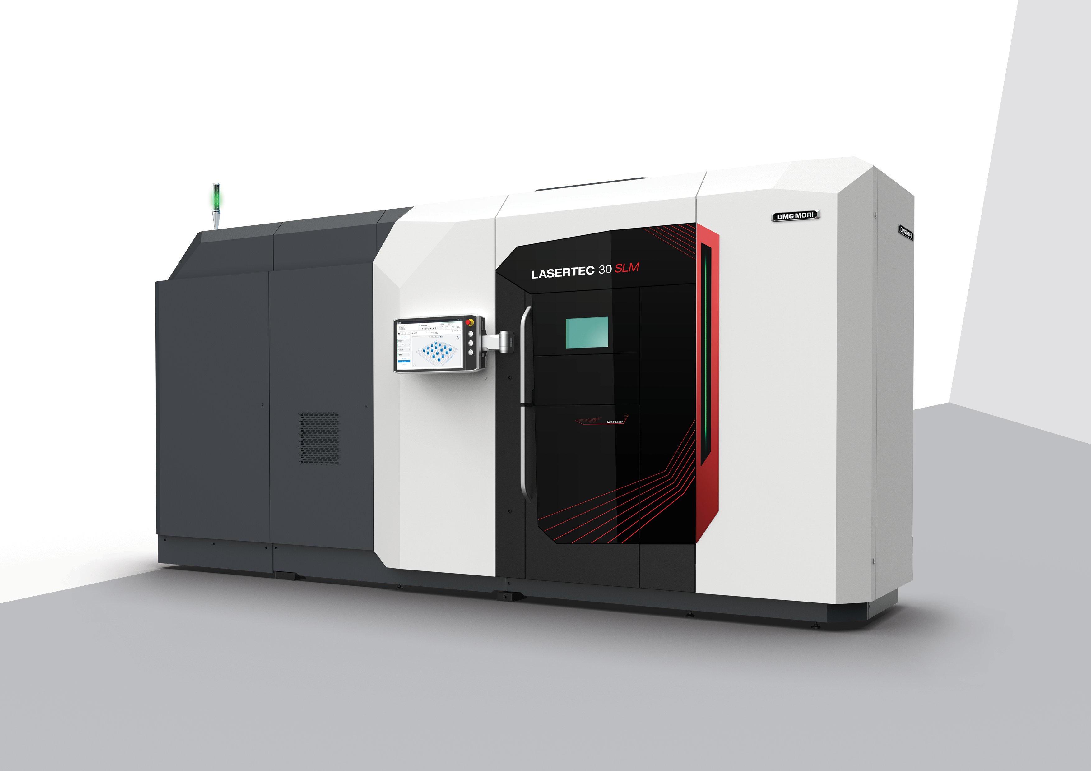

LASERTEC 30 SLM 3. Generation: End-to-end productivity with powder bed-based processing
With the LASERTEC 30 SLM 3. Generation, DMG MORI optimizes metallic 3D printing with an innovative, interchangeable construction container.
In the field of powder bed machines, DMG MORI is setting new standards in efficiency, precision and productivity with the LASERTEC 30 SLM 3. Generation. A key innovation is the interchangeable construction container, which eliminates one of the biggest bottlenecks in metallic 3D printing: the long cooling times after construction jobs. Finished containers can be removed without waiting time after completion and replaced by prepared containers – the machine remains productive almost without interruption. Set-up times will also be significantly reduced, as the preparation of the building boards will be carried out externally in the future. This not only eliminates the need for repeated flooding of the chamber with inert gas, but also significantly reduces the consumption of the shielding gas. An integrated lid system also increases safety and preserves the protective atmosphere between two jobs, allowing powder management and material handling under inert gas conditions. In addition, the machine impresses with its robust design. The stable sprue reduces thermal influences, as does the floating process chamber. Active Z-axis compensation stabilizes the layer height, while up to four fully overlapping lasers ensure smooth and productive material processing. With an expanded installation space of 325 × 325 × 400 mm, larger or more components can be manufactured in parallel, making the machine attractive for series production. At Formnext, DMG MORI will also be presenting the new rePLUG FLEX, a simple version of the proven rePLUG powder module. This variant does not require a closed powder circuit within the machine. On the other hand, the material change can be carried out without an additional powder module – an economical solution, especially for materials that are only used on a smaller scale.
The LASERTEC 30 SLM 3. Generation can be operated easily and intuitively thanks to CELOS X with easyAM. Camera monitoring of the powder bed also ensures high component quality while minimizing process interruptions. After each layer, the surface is scanned for anomalies and analyzed. A heat map visualizes possible defects and an evaluation system is used to assign an "anomaly score" to the respective layer, the graphical representation of which allows the viewer to immediately check all layers built so far at a glance. A new feature is the function of projecting layer data from the workpiece onto the respective camera image. This makes it easier to assess whether a detected defect actually has an impact on the component or is limited to non-critical areas. With this combination of stability, productivity and digitization, the LASERTEC 30 SLM 3. Generation marks a major step towards industrially scalable powder bed production. Using the example of a robot head from the MATRIS light, DMG MORI will be demonstrating such a manufacturing process at Formnext.
