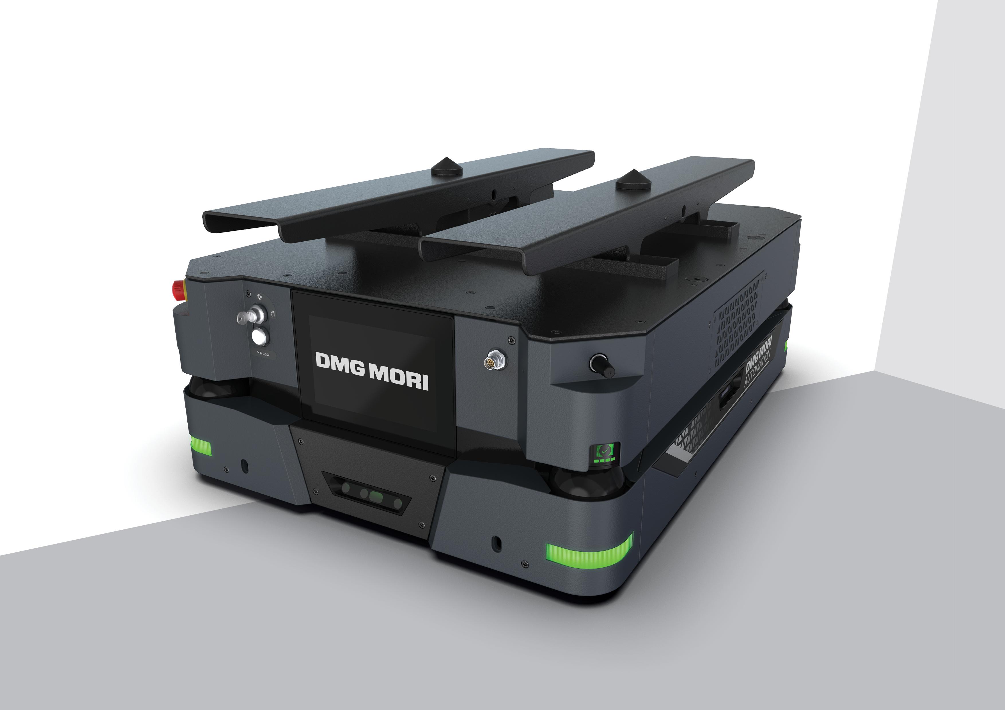

AMR 1000: Autonomous transport of pallets measuring up to 1,100 x 1,100 mm
Themed image
The AMR 1000 is an automated guided vehicle system for pallet handling, material transportation or chip removal.
Like all AMR models, the new AMR 1000 also functions as a collaborative automation solution with free layout design. It moves independently on the production floor at speeds of up to 6 km/h and has a running time of nine hours. The SIMOVE technology from Siemens ensures natural and omnidirectional navigation. As the AMR 1000 can turn on the spot, its space requirement is minimal. It measures 1,070 x 770 x 357 mm. Safety in interaction with people is guaranteed by technologies from Sick and Siemens. The load capacity of the AMR 1000 is 1,000 kg. It is designed for pallet sizes from 800 x 600 mm to 1,100 x 1,100 mm. The AMR 1000 can also perform other tasks such as tool handling or chip removal via additional interfaces. The range of functions makes it a holistic automation system that can be easily integrated into existing processes on the shop floor.
