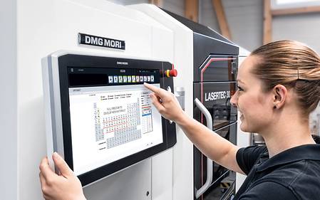

The integral software solution for CAM programming and machine control, CELOS, rounds off the process chains for the LASERTEC SLM series. The coordinated and standardized user interface enables parts to be programmed offline quickly and transferred to the machine – regardless of their complexity. Due to the efficient flow of information and intuitive operation, CELOS ensures an optimum workflow in the pre- and post-processing of additively manufactured parts. As a consequence, the open system of the LASERTEC SLM series enables individual adjustment of all machine settings and process parameters, right through to an extensive choice of material suppliers.

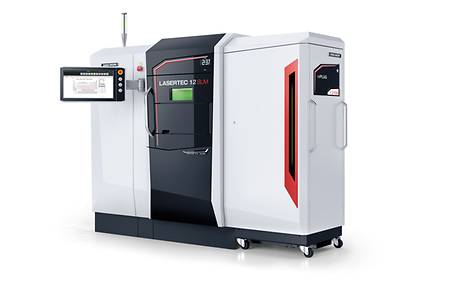

LASERTEC 12 SLM – four-times more accurate than the industry standard
Precision in additive manufacturing depends basically on three parameters, namely minimizing focus diameter, layer thicknesses and powder particle size. DMG MORI has taken exactly these parameters into consideration in the development of the new LASERTEC 12 SLM and has designed a high-precision machine for building the thinnest walls. The top properties and features already familiar from the LASERTEC 30 SLM2nd Generation – the rePLUG powder module, CELOS as an integral software solution, the open system and ergonomic design – also apply without exception to the LASERTEC 12 SLM, making this innovative machine the ideal addition to the DMG MORI portfolio of process chains in ADDITIVE MANUFACTURING.
DMG MORI developed the LASERTEC 12 SLM with a special focus on precision. A small focus diameter of 35µm over the entire build volume enables high-precision creation of the thinnest walls – four-times more accurate than the current industry standard. The thin layers can be built accurately and with exact repeatability thanks to integrated linear scales with a resolution of less than 1μm. An integrated sieving unit prevents larger particles or agglomerates from entering the build chamber immediately before introduction of the powder. In addition, the application of the powder in the build process is carried out safely in an inert gas atmosphere.
Despite its specialization and optimization in the high-precision building of filigree structures, DMG MORI has nevertheless managed to achieve a build volume of 125 ×125 ×200mm – the largest in this accuracy class. The ergonomic construction of the machine in Stealth design also reflects the principle that DMG MORI has been pursuing and optimizing continuously for many years, namely making the machine easy to use and efficient by ensuring better accessibility to all key elements. Furthermore, the LASERTEC 12 SLM is based on the same machine platform as the LASERTEC 30 SLM 2nd Generation, making this new development just as robust while retaining compatibility with both the conventional rePLUG and rePLUG reSEARCH. Rapid material changeover in less than two hours boosts the productivity of the LASERTEC 12 SLM enormously.

HIGHPRECISION SELECTIVE LASER MELTING
LASERTEC 12 SLM HIGHLIGHTS
  • Four-times more accurate than the current industrial standard: 35µm focus diameter
  • Largest build area in its accuracy class: 125 ×125 ×200mm
  • rePLUG powder module for safe material changeover in less than two hours

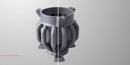

An additively manufactured component replaces several conventionally produced parts
Selective Laser Melting enables STB to additively manufacture highly complex workpieces. “The technology gives us an advantage particularly in the case of new developments, as we do not first have to manufacture a mold for a casting.” This only becomes worthwhile for larger quantities. “What is more, the time saving is 90%.” In addition, SLM technology has manufacturing potential that goes beyond the possibilities of traditional machining: “Such designs would simply not be possible with this degree of compactness using conventional methods alone”, explains Robin Riedel referring to a stainless steel housing, which requires finishing in only a few places following production in the powder bed. In this way, several conventionally produced parts can be replaced with one additively manufactured component. “The cost advantage for the customer in such cases is enormous.”

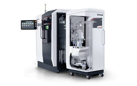

rePLUG powder module for changing material quickly and safely
There were several reasons for purchasing the LASERTEC 30 SLM 2nd Generation, including the long and beneficial business relationship with the supplier. Robin Riedel: “It is an advantage for us to have one point of contact for all our machines.” The powder bed machine is also impressive from a technological point of view. “Rapid powder changing with the help of the rePLUG exchangeable module is a productive, userfriendly and, above all, safe solution.” No powder can escape thanks to the sealed powder circulation system. Until now, STB has been producing stainless steel workpieces on the LASERTEC 30 SLM 2nd Generation. Now, however, the first enquiries for components made from Inconel have started to appear.

rePLUG – THE POWDER MODULE FOR FAST MATERIAL CHANGEOVER
  • Automated powder handling and powder storage under inert gas atmosphere
  • One material per rePLUG – expansion of the material range due to modular changeover system
  • Contamination-free changeover between different materials in <2 hours
  • Safe powder handling thanks to integrated peripherals and sealed material circulation
  • Increased efficiency through integral powder recycling
  • High process autonomy thanks to efficient duo-filter system (filter can be changed without interrupting the process) and large powder reservoir (no manual refilling necessary during the process)
