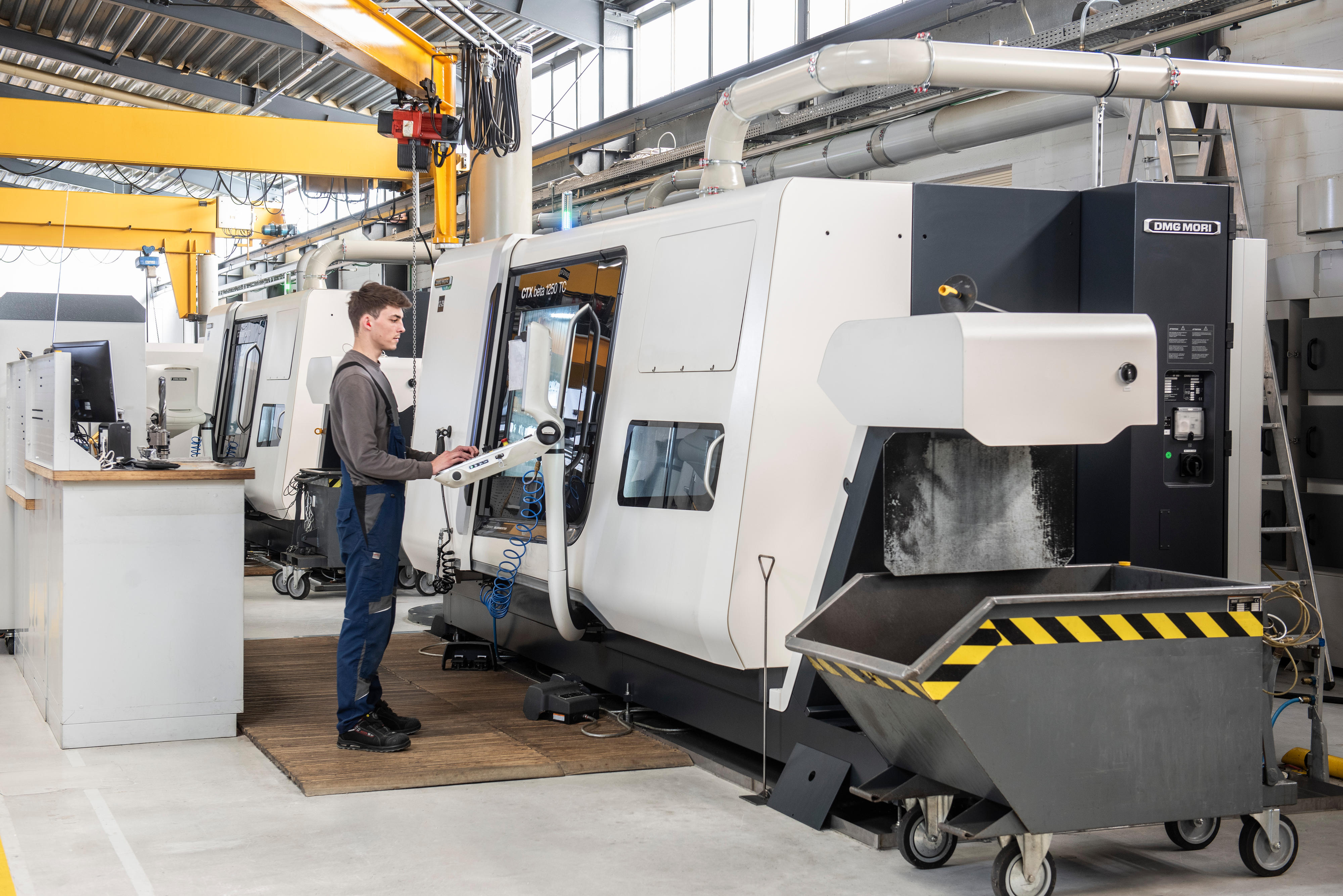

As the control valves consist of a large number of sophisticated components, their precision plays a significant role in this performance. “That's why we only use high-precision machine tools,” says Andreas Petker, referring to the machine park with a total of ten turning centers from DMG MORI. “Complete machining in particular is essential for an economical and quality-oriented production.” This explains the high proportion of turn & mill centers. Larger components are machined on three CTX gamma 2000 TC, which HORA opted for at the time because of the user-friendly ShopTurn programming. For Waldemar Benks, who is responsible for process design in the machining department, this is an important factor in day-to-day business: “In these cases, we program the components exclusively on the machine, so ease of use is crucial.”
CTX beta TC for maximum component diversity

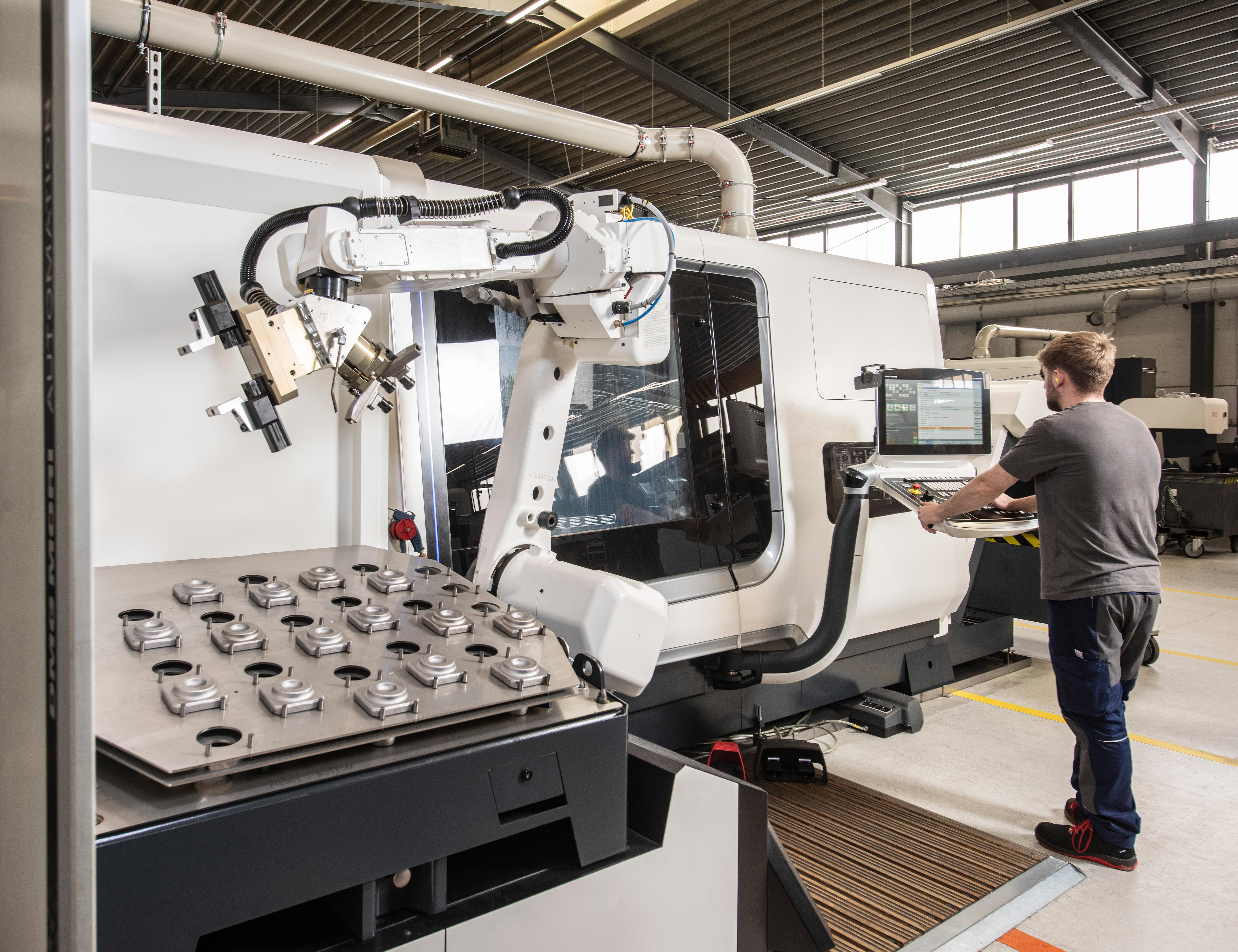

The CTX beta TC models purchased at a later date offer space for an extremely wide range of components. “Thanks to their versatility, we can use these machines to capacity practically all the time,” explains Andres Petker. One of the CTX beta 1250 TC also has a Robo2Go, which processes orders with small batches in unmanned shifts. “However, the rule is individual parts that have to be processed correctly in the first attempt because the raw material or cast parts are procured specifically for the order,” emphasizes Andreas Petker. HORA meets the high standards in production with well-trained specialists – including from its own training workshop. A lathe from DMG MORI, a CTX 350, is also used here.

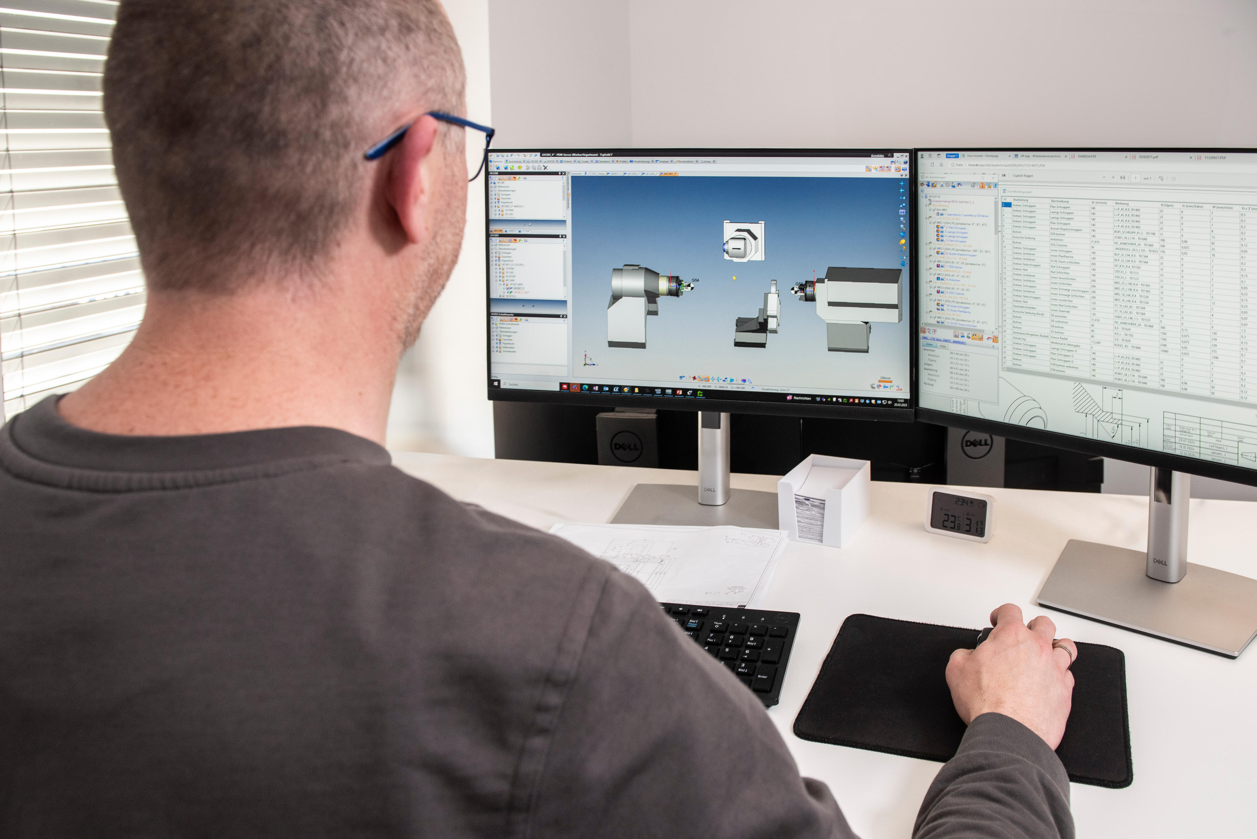

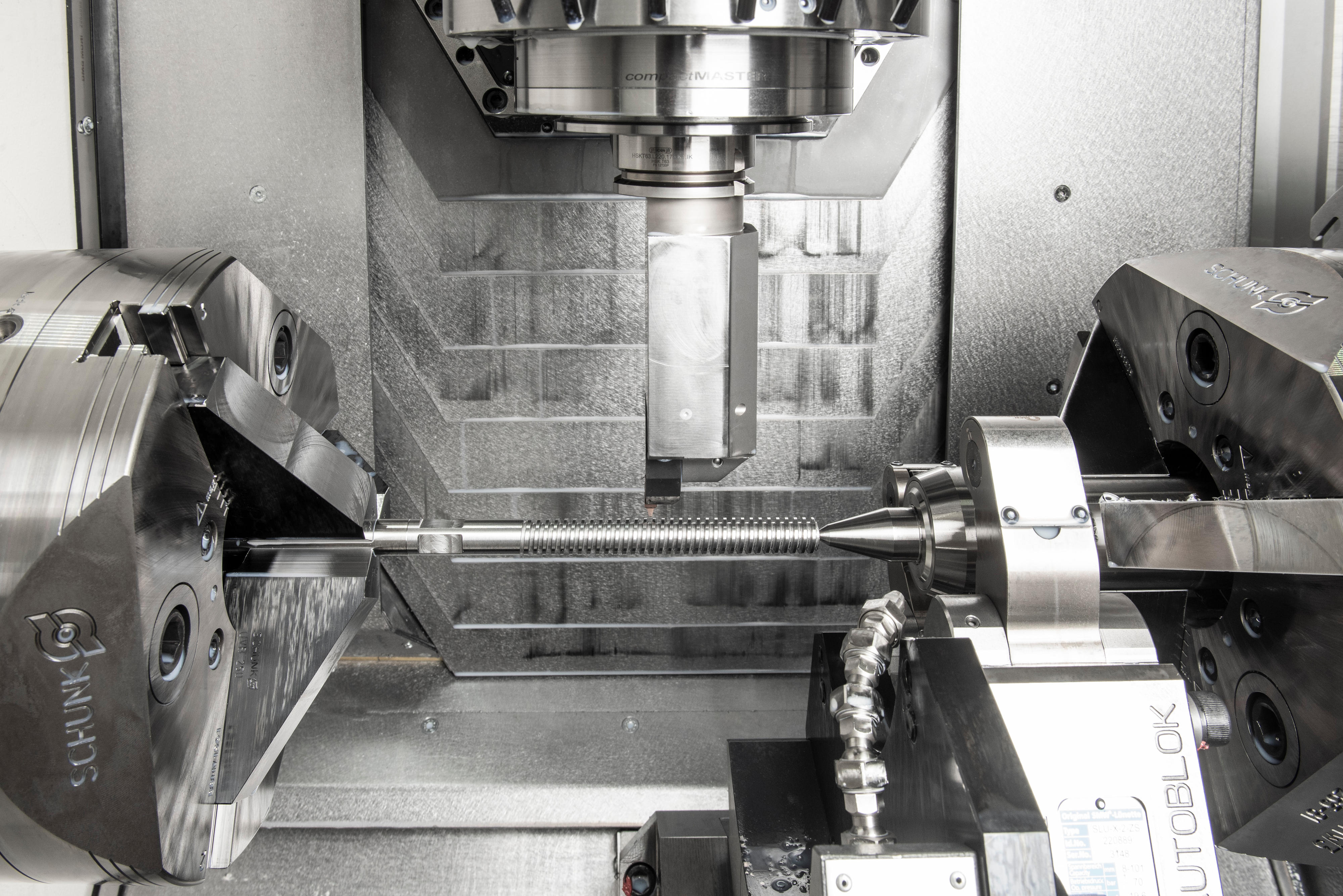

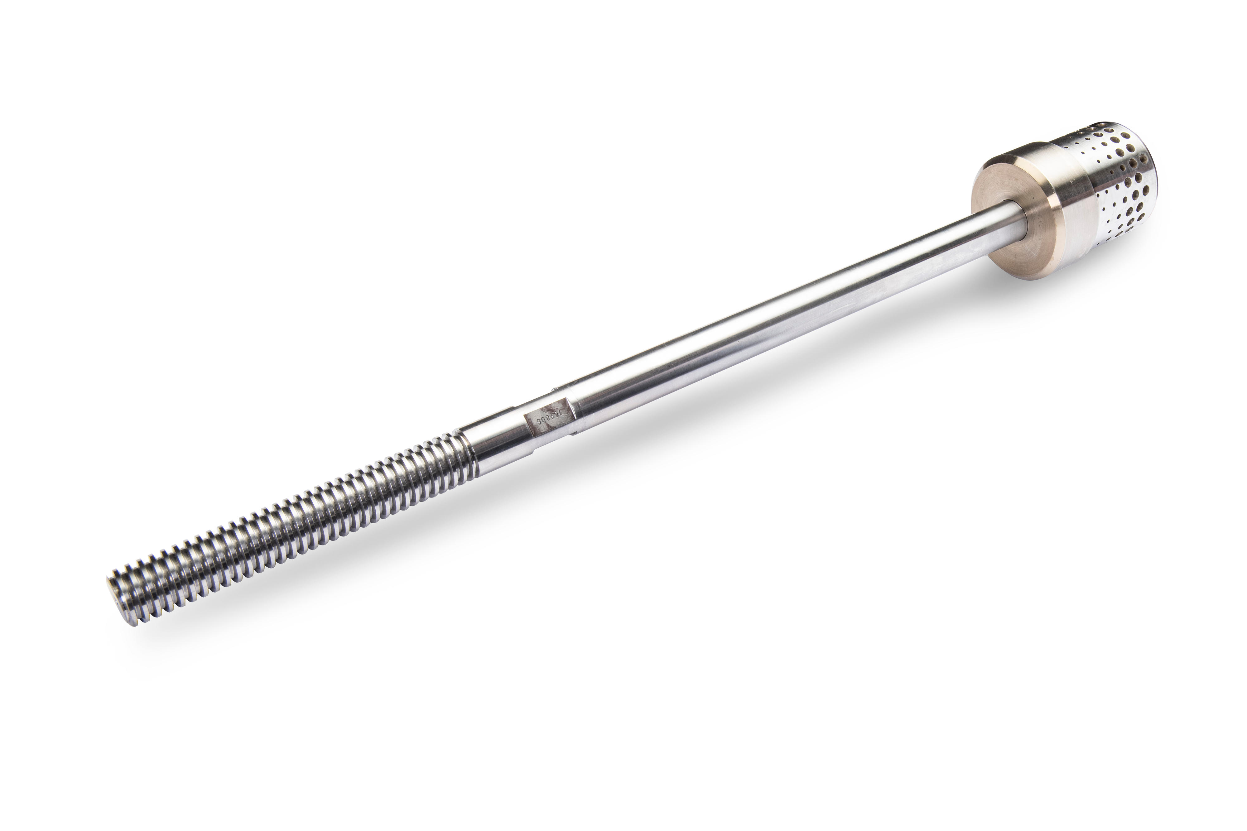

The CTX beta TC turning centers are programmed centrally via a CAD/CAM system. “We have equipped all machines in the same way so that we can process the programs flexibly at any time,” says Waldemar Benks, describing the workflow. The latest model also has a steady rest and the DMG MORI Multi Threading 2.0 cycle. “This special feature contributed significantly to the purchase decision.” The technology cycle allows free definition of contours, pitches and threads. “This made the machine particularly interesting for us, because we saw a good way to make the production of spindles with demanding trapezoidal threads more productive,” adds Andreas Petker. The result has confirmed expectations. The increase in productivity is 50 percent. “This is due to both the simple programming using the technology cycle and the special tools that we developed for this application together with the tool manufacturer Paul Horn,” says Waldemar Benks, looking back on the extensive project. The tools work with low vibration and therefore offer longer tool life and better process reliability. “On the one hand, this is more effective and, on the other, we can now leave the machine to work unattended.”
