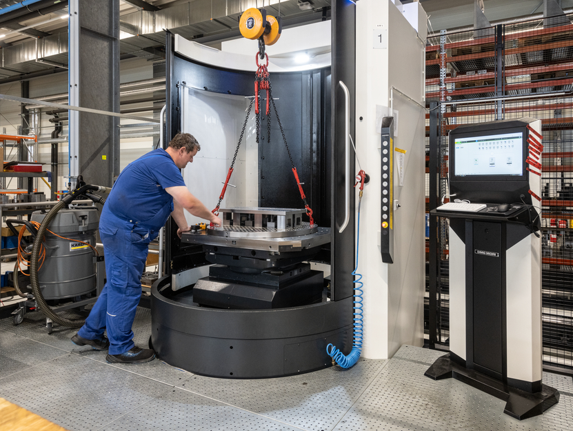

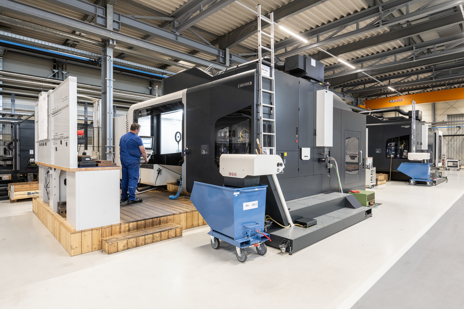

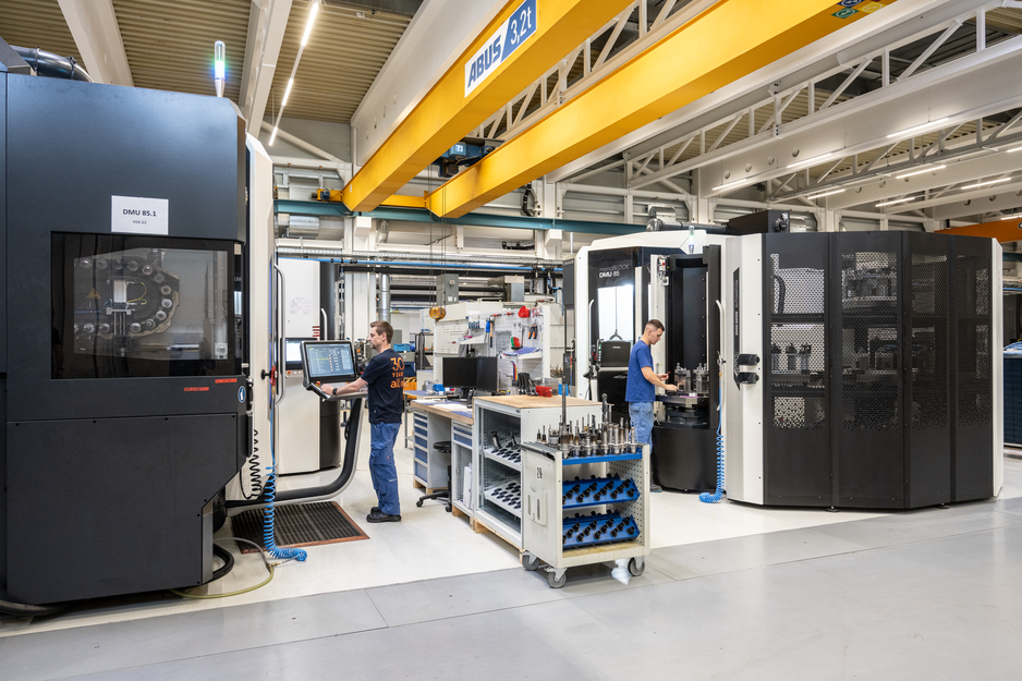

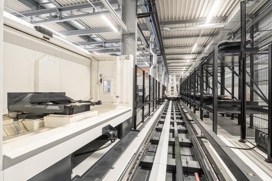

According to Georg Sandig, Head of Mechanical Machining, there were several reasons for modernizing production: “On one hand, we needed to increase our capacity, and on the other, we saw potential in automation solutions to become even more flexible,” he says with regard to pallet handling. The LPP 5000, for example, has space for 20 pallets and is loaded via an ergonomic setup station. “Accessibility is better than in a machine shop, and we can prepare orders while the two machines process them with minimal downtime.” Orders are managed by an in-house developed MES system that prioritizes the sequence as required. The advantages of the LPP 5000 also apply to the four PH Cell 800 machines. Each of these has space for up to 18 pallets. Norbert Demarczyk adds: “The pallet handling systems enable us to manufacture small series very efficiently.”
The right tools for every component

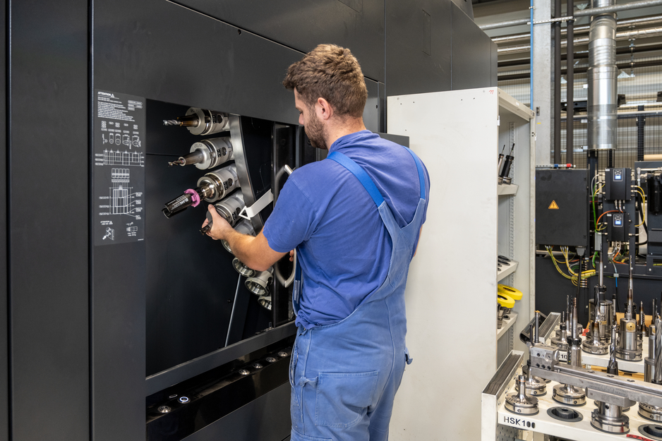

The components on the pallets measuring up to 1,250 x 1,000 mm in the LPP 5000 are machined by two DMC 160 duoBLOCK machines. According to Georg Sandig, a highlight are the large tool magazines with 303 stations. “This was an important criterion for us because prototypes are often machined with an enormous number of different tools.” Accordingly, the warehouse contains over 15,000 different types of tool, many of which are expensive special tools. “Probably the largest in Central Saxony,” he jokes. Transparent tool management helps to keep track of everything. “Since we don't mill from solid billets here, we can use the tools for a relatively long time with appropriate maintenance.” The large number of tools illustrates the complexity of the prototypes. “High-precision machining centers for 5-axis simultaneous machining are absolutely essential here,” emphasizes Norbert Demarczyk. “On an older DMU 160 FD duoBLOCK, we can even completely mill and turn parts economically.”

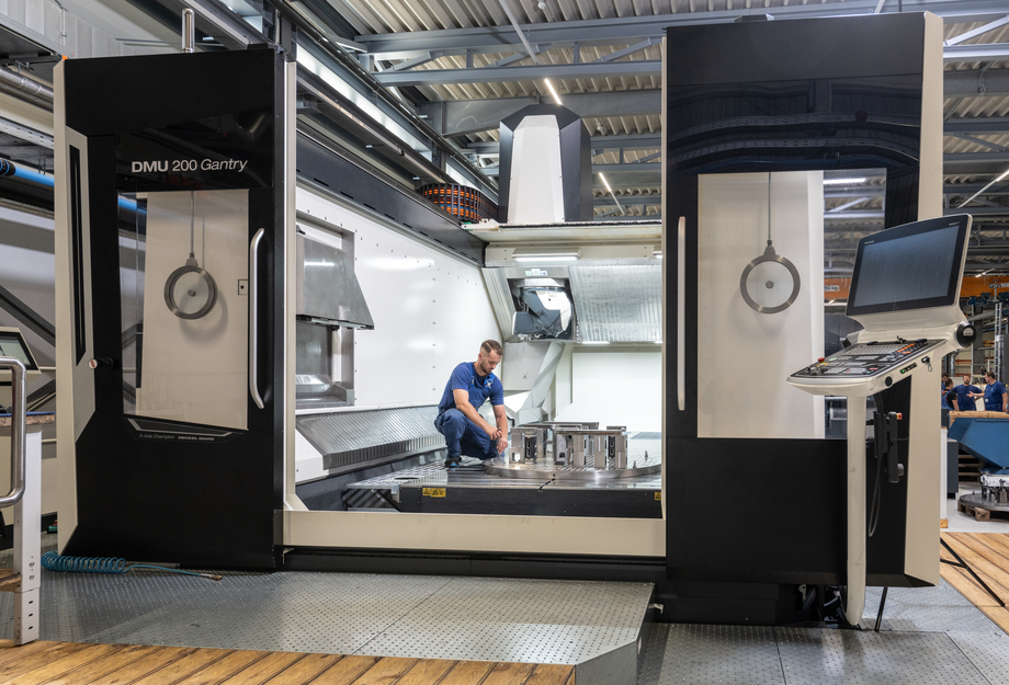

ACTech made the investment in the second location after careful planning. “We have enough space here to continue growing, for example by mirroring the LPP and doubling capacity,” says Norbert Demarczyk, referring to the available production area. Giga casting is also a topic of discussion. “The DMU 200 Gantry expands our capabilities in the machining of large underbody structures for electric vehicles.” The variety of machining options helps to open up new markets. He cites Japan and China as promising examples. In terms of industries, he sees potential in drive technology and the aviation industry, among others: “Wherever development cycles are becoming shorter, we benefit from our many years of expertise in prototype production for automotive manufacturers.”
