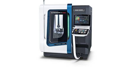

World premiere: ULTRASONIC 20 linear 2nd generation
With the ULTRASONIC technology developed in collaboration with SAUER, DMG MORI has for many years now been offering high-performance machine tools for the high-precision 5-axis machining of complex workpieces made of advanced materials. The series has now entered a new league with the new ULTRASONIC 20 linear 2nd generation. Extensive optimisations across the board, from the expanded ULTRASONIC technology and the machine construction, the performance and on to including options available, further enhance the technical edge of the machining center. Spindle speeds of optionally up to 60,000 rpm, more powerful drive motors, an even smaller footprint plus CELOS with applications developed specifically for ULTRASONIC are among the innovations that users from the optical, clock and watch, medical and high-precision mould construction sectors will benefit in future.

Highly dynamic, long-term stable 5-axis machine concept – compact on 3.5
DMG MORI relies on the long-term stable gantry design for the ULTRASONIC 20 linear 2nd generation in order to meet the demands on precision for ultrasonic machining. Whereby the machine tool manufacturer was able to reduce the footprint to a compact 3.5 m². A duel drive in the Y-axis and the integral cooling concept that includes temperature monitoring of drives and spindles as well as the control cabinet and all media guarantee top precision and component accuracy. The linear scales from Magnescale are another example of the high-tech components used by DMG MORI here.
DMG MORI has increased the performance of the drives significantly in its latest development: by 47 percent in the A-axis, 27 percent in the C-axis and 34 percent in the Z-axis. The linear drives achieve maximum accelerations of > 1.2 g and a 50 m/min rapid traverse. With the very large swivel range in the A-axis of the work table of -15° to 130 ° and the fully integrated infinitely rotating 360 ° rotary axis – both with torque technology – the ULTRASONIC 20 linear 2nd generation is optimally equipped for highly flexible 5-axis simultaneous machining. The up to 1,500 rpm available as an option for the C-axis enables cylindrical mill-grind and mill-turn operations.
