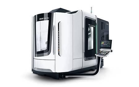

DMG MORI Industry 40 02A DMC 80 FD dB
Although not visible from the outside, the two DMC 80 FD duoBLOCK machines of the innovation project “machine tool 4.0” are nevertheless packed full with intelligent sensors as the basis of condition-oriented service and maintenance. To achieve this more than 60 sensors have been installed on elementary components of the FD machine.
Calculable availability of means of production ranks as a decisive factor in the realisation of cyber-physical production networks. This has led to the optimisation of service and maintenance processes progressively moving away from the back burner and into the limelight. That is why DMG MORI has collaborated with Schaeffler Technologie to start the innovation project “Machine Tool 4.0” taking the mill/turn centre DMC 80 FD duoBLOCK as a specific example. To achieve their aims more than 60 sensors have been installed on elementary components of the FD machine. Together with other (obligatory) status information all data are now captured in realtime and analysed using specially developed algorithms. As a result the evaluation of the data provides qualified insights into the probable occurrence of different process and production faults. This in turn enables users to take targeted measures in advance for the first time, where currently unplanned machine downtimes quickly render capacity planning a waste of time. The extent to which the above-mentioned theory is actually implemented in day-to-day machining routine can be experienced live by visitors to the DMG MORI stand at the EMO in Milan. Energy and running costs have also been reduced significantly in addition to the increase in availability and simultaneous reduction of service costs. This new “knowledge” also constitutes the basis for the sustainable optimisation of processes, products and machines.

Comprehensively equipped with intelligent sensors, operating status and process data are collected continuously for the DMC 80 FD duoBLOCK in realtime and saved, processed and analysed both locally on the machine in CELOS as well as in the cloud.
Both machines have an identical integral Industry 4.0 concept, from the sensor to the cloud, that connects existing technology with the new possibilities of digitalization and data analysis and thus masters the close interplay of mechanics, electronics and information technology. Comprehensively equipped with intelligent sensors, operating status and process data are collected here continuously in realtime and saved and processed both locally on the machine in CELOS as well as in the cloud. In addition the collected data are analysed in the cloud using specially developed algorithms in order to detect potential faults or problems in the process by means of qualified forecasts. This status information is then fed back to the machine. DMG MORI has developed a special CELOS APP – the “Condition Analyzer” – that functions as the information centre on the ERGOline control with CELOS and via which all status information is visualised and from where the operator can immediately initiate any actions that might be necessary.
